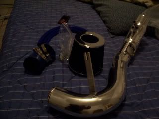

i got mine used so this is the one i used

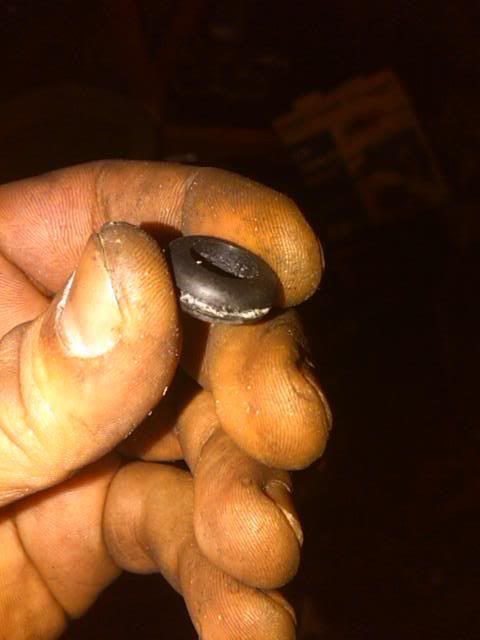

ofcourse i did have to mod the tube a little by wrapping it up with tape around the maf sensor hole and drill a hole and put a rubber adapter so the intake sensor will fit snug

now that you've done everthing its time to go in, you have to go from the bottom up and it should make it easy..i just bend the bracket to fit,etc,etc......heres how mine looked after i was done..it bolted up direct and fit just fine the only thing that bites is its a ebay cai:shady:
if you use a 3"k & n filter you might have to figure out a way to push it in more( i melted the inside so it could go in more cause k & n filters have a guard so you don't push them in too much) any other good filter will work (fujita,aem, or injen)
