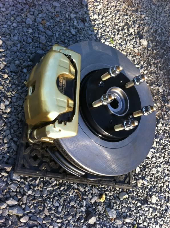

Acura RSX TYPE-S 5 Lug Swap
TYPE-S Brakes
ARP Extended Studs

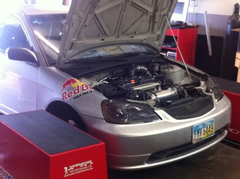

Engine
K20A2 TYPE-S
Hasport / Innovative Mounts
Polished RBC Intake Manifold
Revhard Turbo Manifold
Garrett GT28 Turbo
Tial 38mm Wastegate
HKS BOV
Custom Built 2.5" Piping
AEM Dryflow Filter
K-Tuned Coil Cover
So-Honda Garage Valve Cover w/ welded -10an fitting
Mishimoto Aluminum RSX TYPE-S Radiator

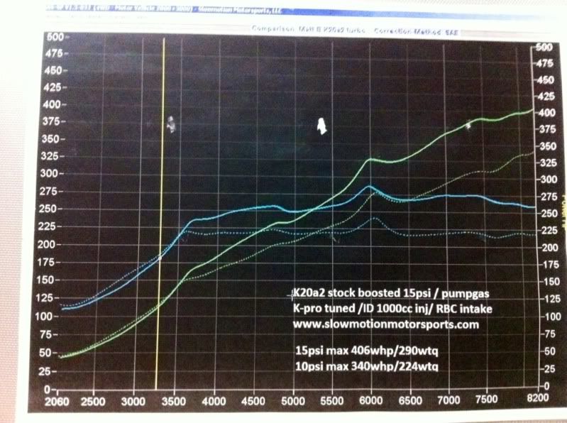

Hondata K-PRO

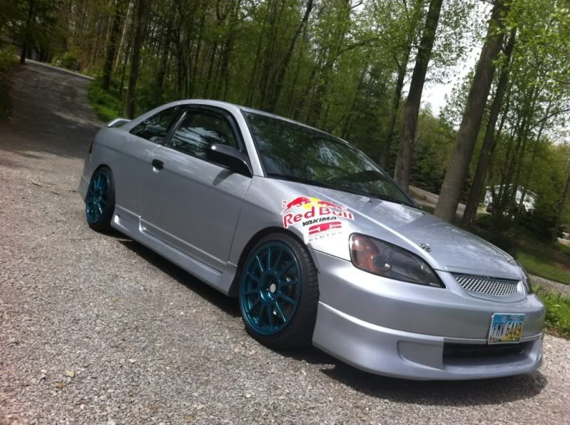

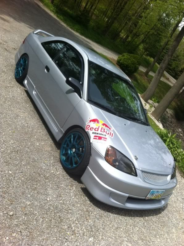

The huge Red Bull Sticker is cover a Huge scrape and wrinkled fender. LOL cheap fix and doesnt look as gay as a band aid sticker.
Ballin on a budget, I see you hah. Is the interior converted to rsx interior too?

damn!!! bay is clean, fix up the exterior and u got urself a fine car!
Yeah the exterior is in progress now. The car was pretty beat when I got it. Had a huge body kit epoxied on and dents all over.

Swap and bay are nice, i just can't like the exterior of the em2s, especially with that kit.
The Em2 was def not my first choice of car but the deal was to good to pass up and its starting grow on me. I'll have to get some more pics of the car I think the lip looks great but the pics make it look bigger than it seems in person. :thumbsup:

The exterior would drive me nuts. Different lip kit and grille will fix it. It surprised me what I saw under the hood. :thumbsup:
I resprayed the center part of the grille mesh today and changed the look quite a bit. I need a badge or emblem for the grille and I think it would look better.

Just sprayed it black. Didn't want to get carried away with it since I'll probably end up with a Sidewinder Setup so I can make more power.. Didnt think I'd get bored with a 400+HP Civic that quick but ready for more..:thumbsup:
