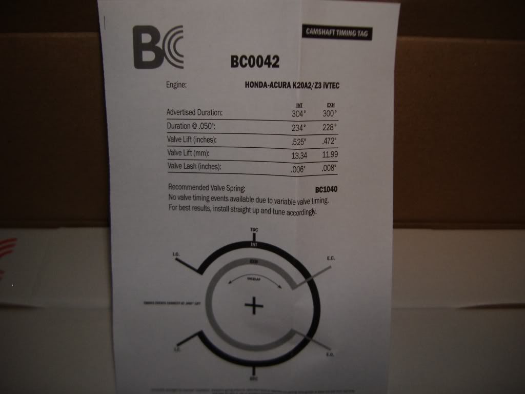

No, this is NOT a thread asking the difference. This WILL be a thread SHOWING the difference. I should have the brian crowers in my hands TOMORROW! I will be installing them soon and posting up my results after I get tuned at church auto, with a comparison line on my dyno graph of my previous setup of Crower Stage 2 cams.
This thread will be dedicated to the difference of Crower Stage II 3/4 Race NA cams vs. Brian Crower Stage II 3/4 Race NA Cams on a FULLY BUILT SETUP!

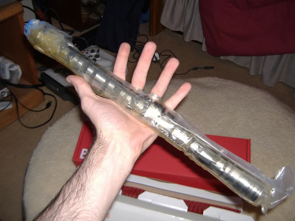

Cams are in my possession. They get installed this thursday and I'm goin to church on saturday for tune and results!

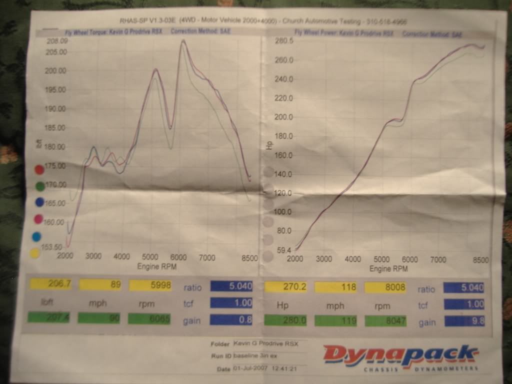

New Dyno
This is from the dyno day that was held at church's at the end of June. This is showing the difference from my old 2.25"ID exhaust to a thermal 3" exhaust on the Brian Crower cams.
