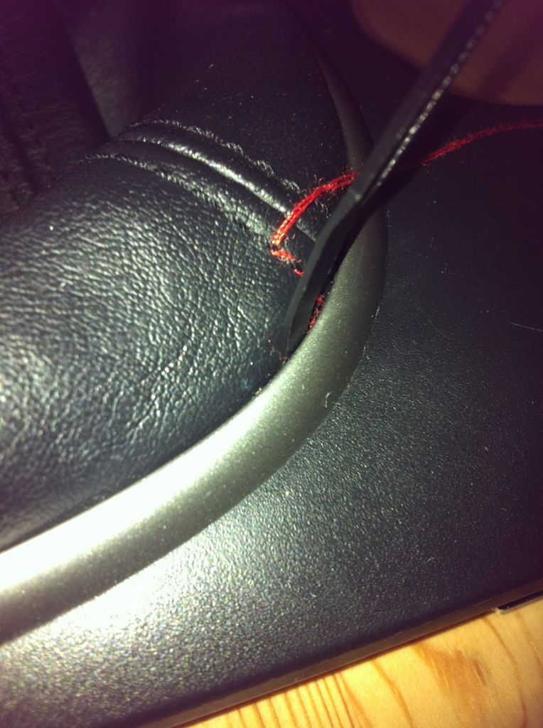

Step Two:
Gently Tuck on one corner of the shift boot to reveal some of the first stitches

Step Two:
