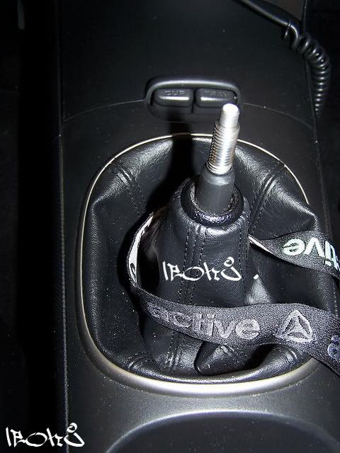

take off your shift knob. if you can't do this step. don't bother continuing with this DIY

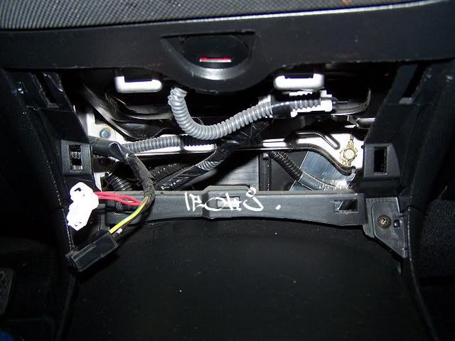

next take off your mid console part. careful not to break the clips! then remove the two gold screws.
then take off the upper part. once again be extra careful not to break any clips. then remove the 2 black screws. and unplug the power from the cigarette lighter
next remove the two screws in the back. you need to pull your seat all the way to the front to see the screw. theres one in each side. dont forget to unplug the wire from the cigarette lighter. then remove console.

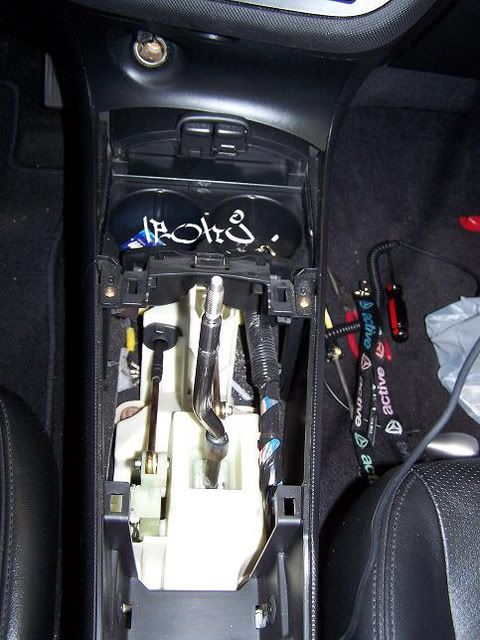

it should look like this once you remove the center console.
