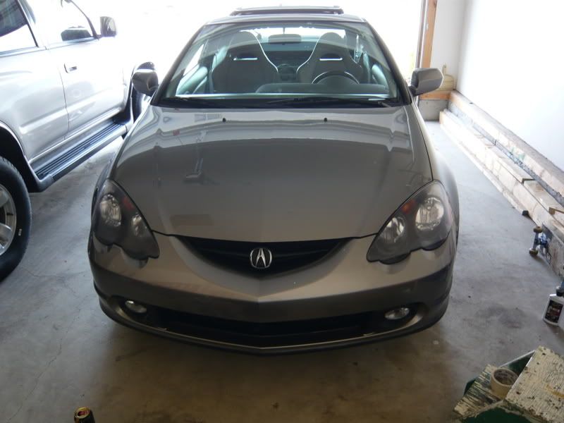

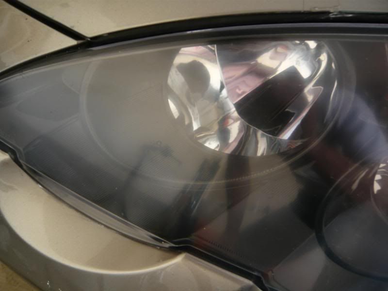

So I blacked out my headlights last week. The end result was very nice however I really could see the hazyness and scratches on my headlights.

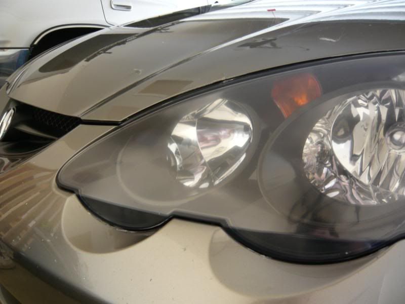

This is what they looked like ( notice the hazyness )
So i decided to do a proper cleaning job and create a DIY for anyone who needs this done. I know there have been others made but not with detailed pictures. I hope this will help someone.

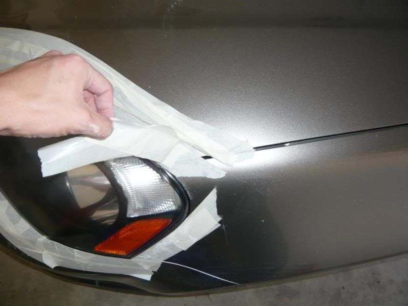

Mask around headlight to ensure you will not scratch your paint.

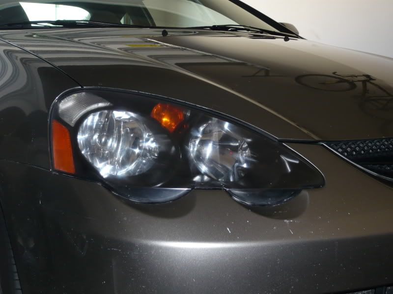

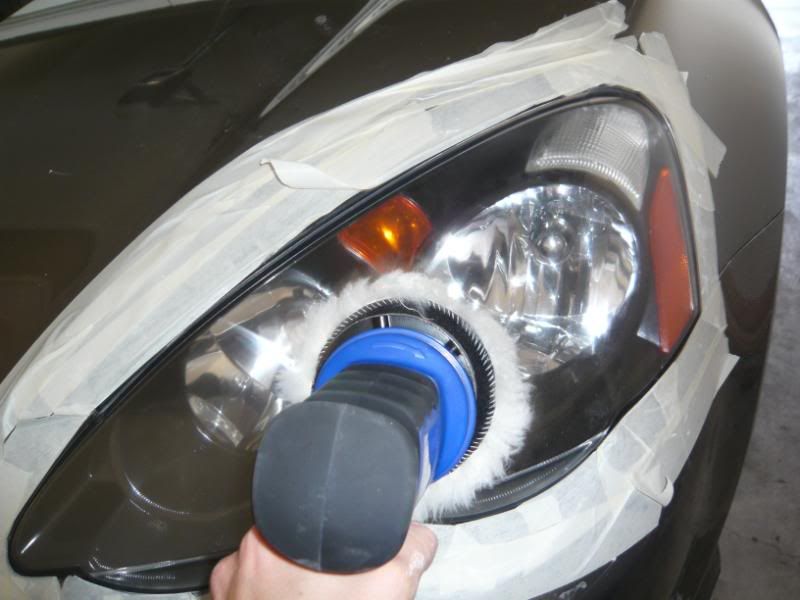

Result after sanding
Step 6

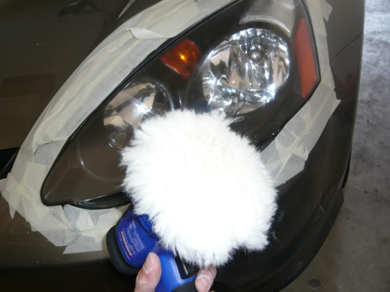

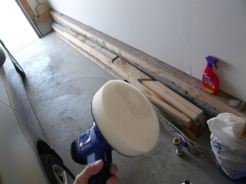

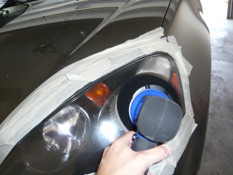

use your power polisher with a 4" foam pad and use a circle of Plast X and spead a nice even coat of polish over your head lights.
