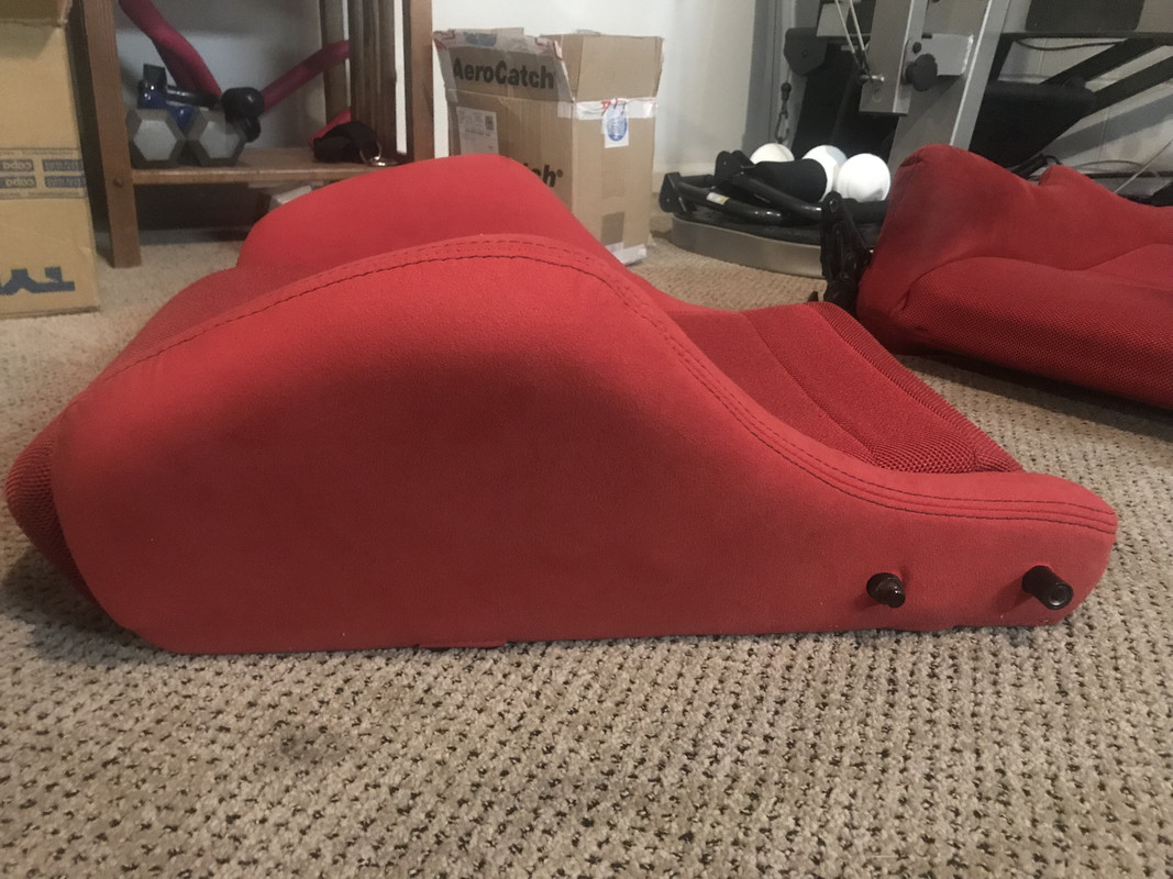

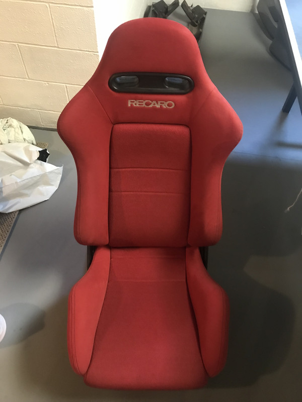

The starting point after removal and slider removal.
Follow disassembly procedures listed in the above posted link.

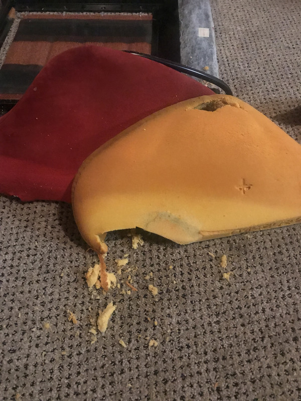

The standard dreaded bolster blow out.

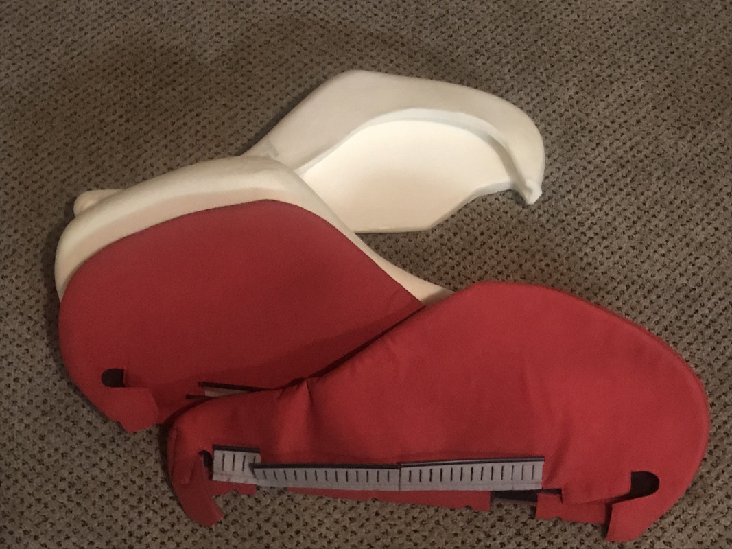

The new “goods”:thumbsup:

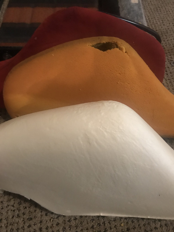

After tear down the damage observed. Sadly a lot of these
seats experience this from the use over the past 17ish years.
New vs. old bolster foams.
Side profile of the new product.

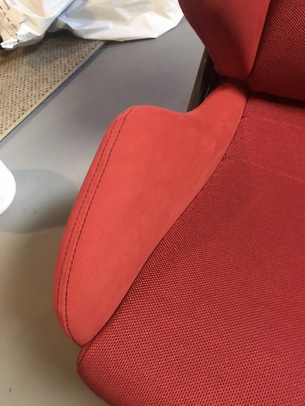

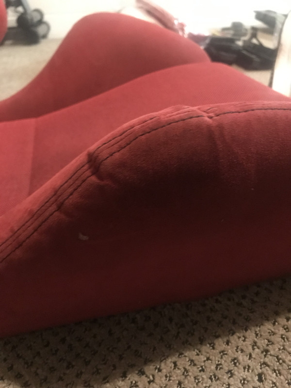

Finished product.

Now just as a disclosure no one makes DC5 foam replacements...as in no one in the entire world as I searched high and low before diving into this project. The foams and suede covers used here are DC2. They mount the exact same, and the only difference is they are slightly thinner near the hips (honestly not noticeable).

is that a gap between the seat base and the right bolster? on the last picture.

No that’s a shadow. Pictures are from my basement which has terrible lighting. Fitment on these replacements was spot on...so tight actually it was a little bit of a pain to install at times.
