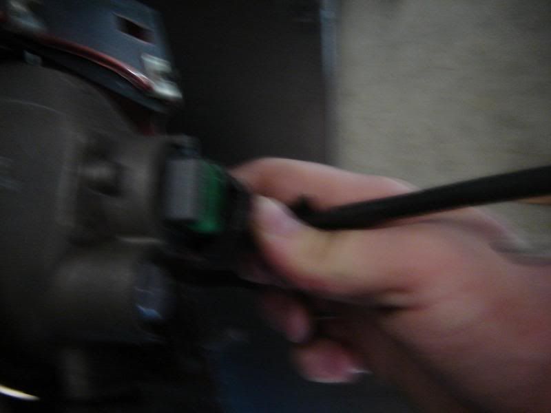

Fog light wires are next, if you have them.
Pull them in a downward motion to remove them. May require some force.
You are done, and you have access to everything you need for CAI, and other fun mods.
