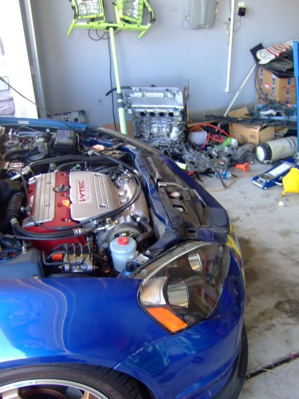

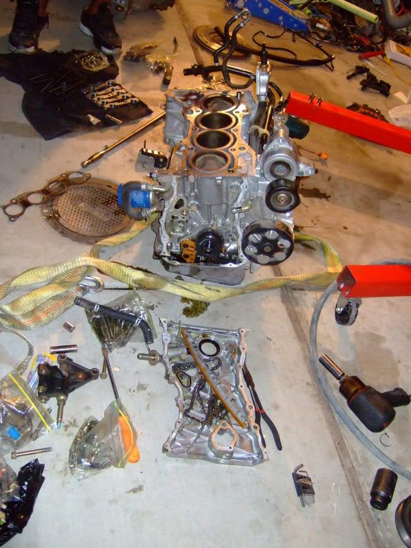

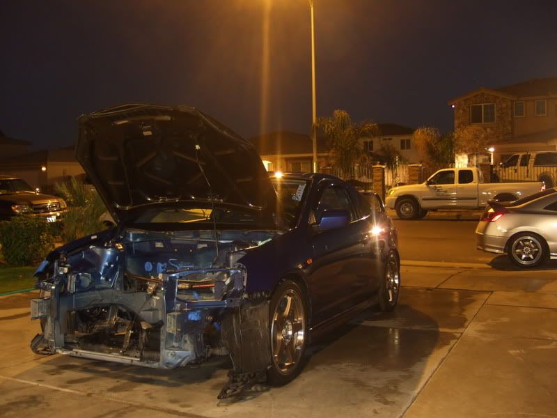

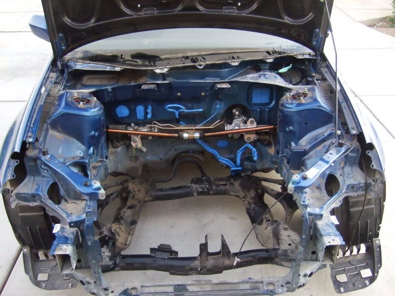

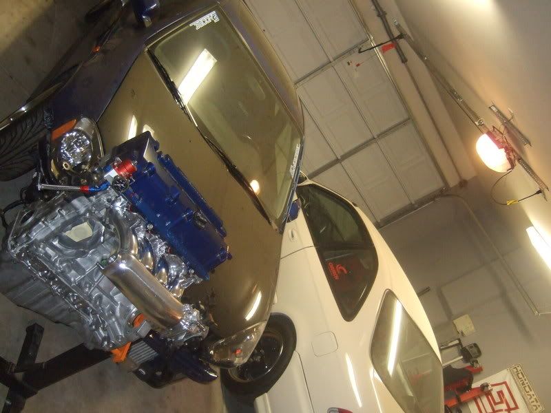

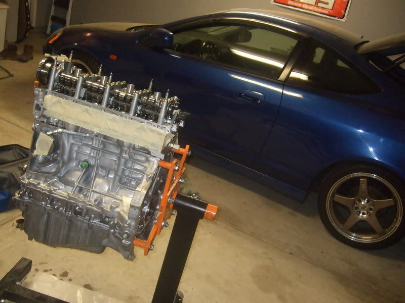

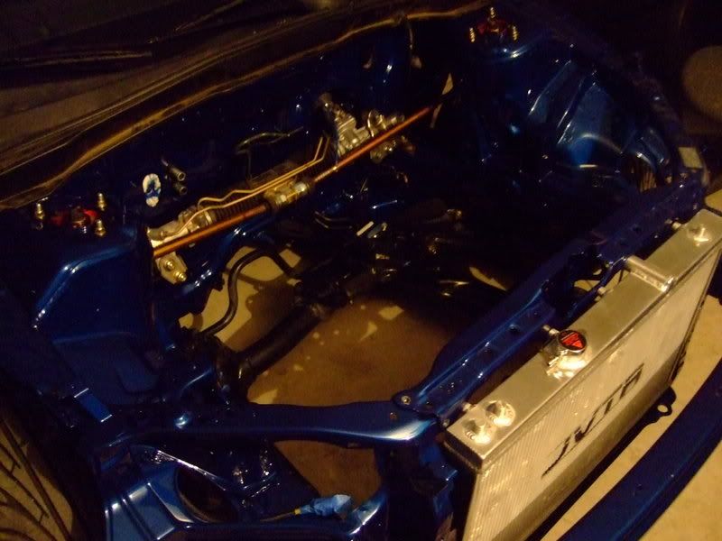

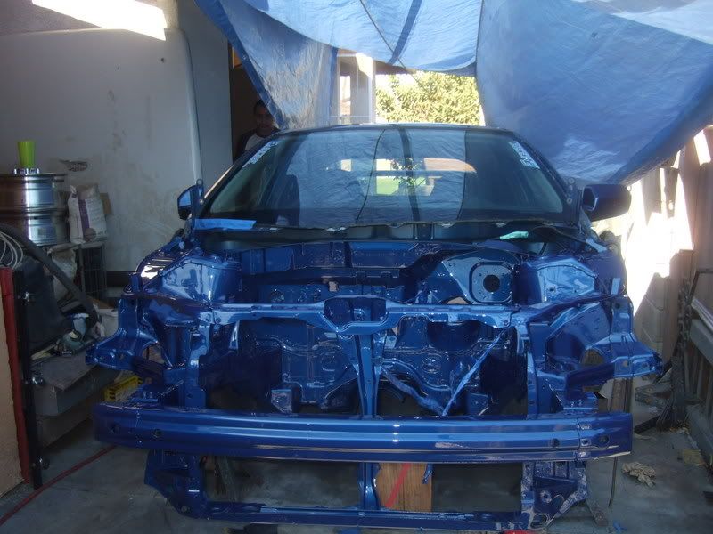

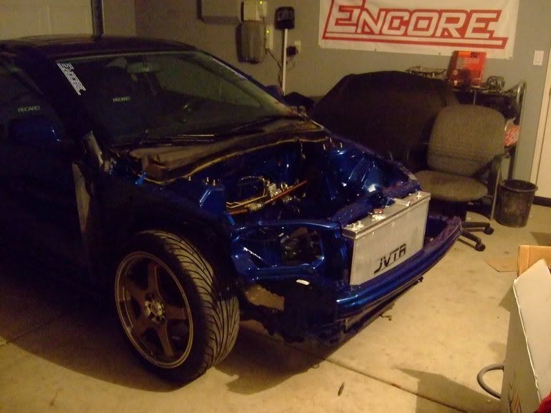

Ok so heres my project finally done, here what my Setup consist of...
ENGINE
GE sleeves 86mm
Arias pistons 9-1
Pauter Rods
OEM Bearing, Rod and Mains
Supertech Valve Springs
Supertech Retainers
Brand new Stock Valves
3 angle valve job
OEM Headgasket
RBC Intake manifold
JVTR radiator
Samco Hoses
TRANS
5 speed ep3 trans
wavetrack LSD
Competition Clutch stg 4
TURBO SETUP
Peakboost Turbo Kit
Garret Gt35R .82
Tial Wastegate 44
Tial BOV
Peakboost Downpipe
Peakboost test pipe
Thermal 3" Exhaust
Peakboost Vac. block
FUEL
Bosh 044 Pump
Aeromotive FPR
Aeromotive Filter
-8 Feed to rail
-6 return to stock feed
1000 RC injectors
GE fuel rail
Thanks to Ken @ PEAKBOOST for all the help
Car has not been tuned yet... Power goal is 600HP ill be tuning within the next couple of weeks
Here are some pics of the Build Enjoy....

Can I get a pic of the front of your car straight one and alittle lower.looking to get a good shot of the radiator. nice build man!
yeah ill take a pic later on....
