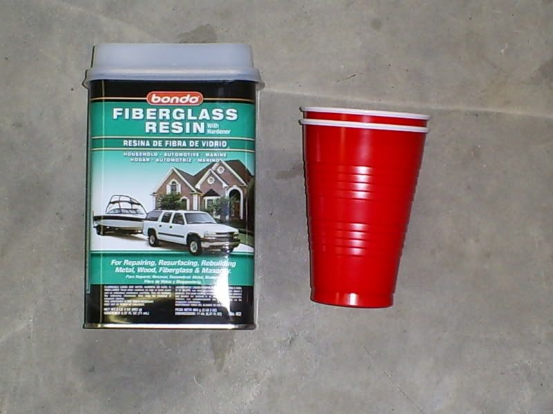

Now to the fiber glass part.
Fiberglass resin with hardener From wal-mart and platic cups
Fixed me up a nice little stand.
Used a little heater to keep me and it warm plus dry a little faster.
Apllied the first layer of Resin
With next coat ill get it more evened and spread out i just wanted to get it started and hold shape.
