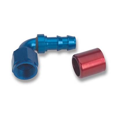

these type hoses
these type fittings

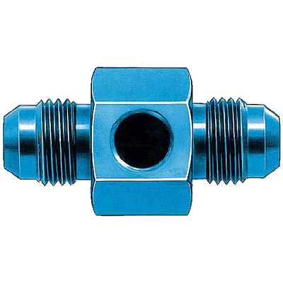

I also stuck this below the FPR and hooked up a Fuel Gauge (gauge reads 0-100 psi)

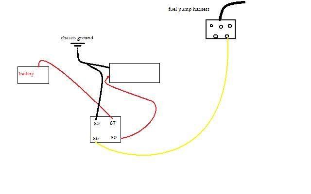

here's the Bosch 044 pump diagram which i made
The box with the numbers is a 4 pin relay you can buy at RadioShack or AutoZone.

78006ERL
no theres a number missing for the footage for example 781006ERL (10 ft) 782006ERL (20ft).... jd couldnt figure it out...

yeah about how much do use exactly 15 ft ?
4039whp 2956wtq @ 88psi
10,469 Posts
i just looked that up... thats more than buying 20ft of it lol
