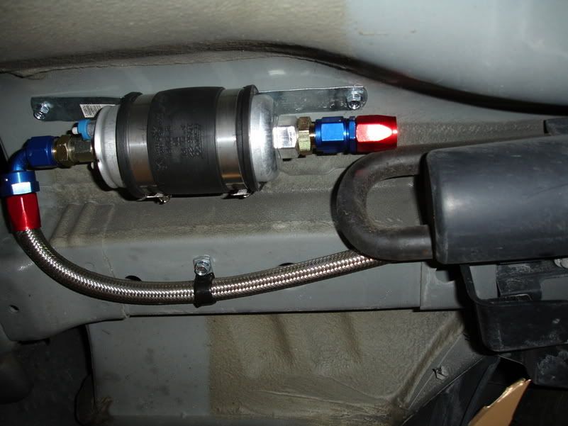

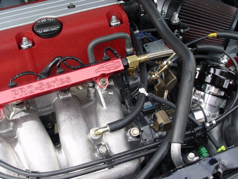

Well I finally had some time to work on my fuel set up. Since I could not get the bosch pump to work for some reason, I decieded to try running 2 walbro in tank pumps. I did not like the way that was going so I decieded to try the bosch pump again. I believe the reason it did not work before was due to the location. This is where I had it mounted before

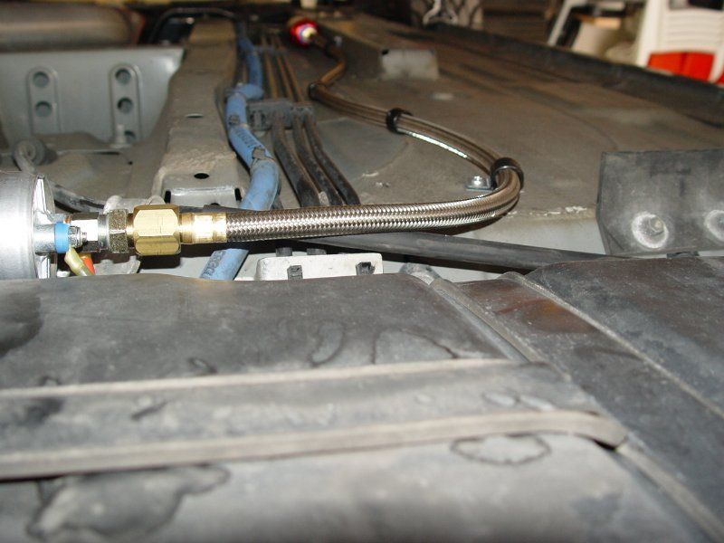

Here is the new location

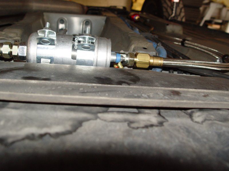

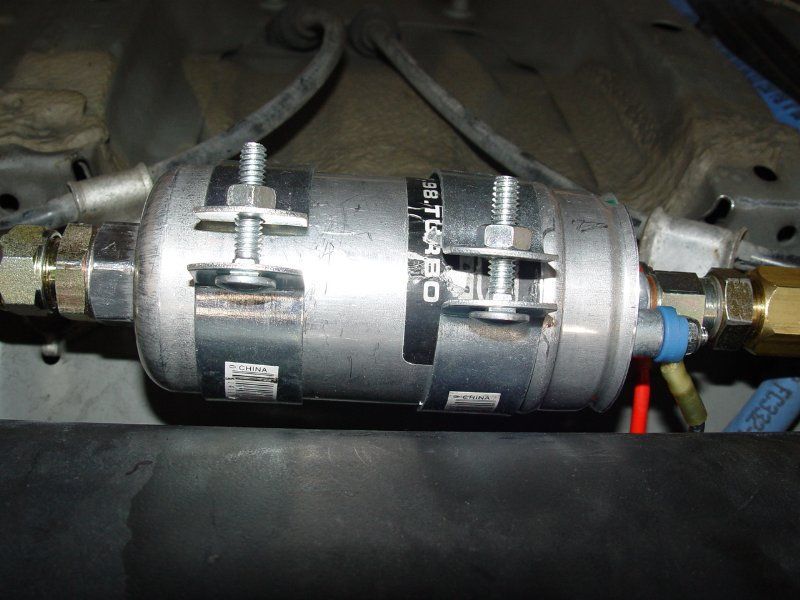

This shows the line going to the filter then to the rail

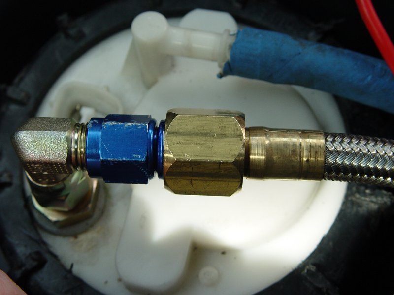

here is the new fuel feed line

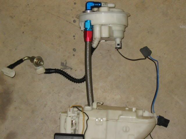

here is the top of the fuel pump assembly. The reason I have the adapter from a -6 to a -8 is because I already had the -6 bulk head fitting in the top of the assembly, I honestly did not see how I would have any more room to drill a bigger hole for the -8...The blue line is the fuel return
This is how the pick up is ran I have rany my car with the gas light on and have not had the lean cut problem yet :noes:

If I where to do it again I would not buy earls steel braided line it is to expesnive, I had new lines made at a local hose shop with fittings for half price. If anyone needs help feel free to pm me

All the pick up consists of is a filter that you get with a walbro pump and a -8 fuel line, it sits where the stock pump use to be
