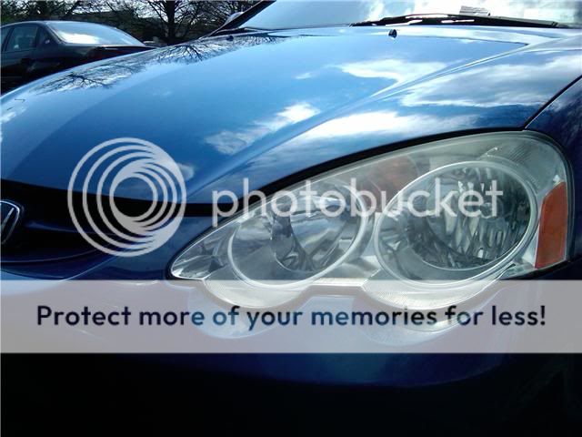

For some reason my hood looks like it doesnt close all the way in the front. It looks closed from the sides bit there is a gap between the front of the hood and where there bumper comes up by the grill and also the lights. Is there a way i can fix this? **Also there is a little bit of shadow in the picture too, sorry
Note- My loodlatch was broken and i had a shop weld it back on and i was wondering if that could be the problem too. But they welded it right back on to where it snapped off so i dont think its in a differet position.

i adjusted the rubber stoppers and it fixed it. One of the stoppers was all the way cranked up and the other down, probably from people playing with them when my hoods popped not thinking anything of it. Thanks guys

Hey guys, sorry to bring this thread back. But, I got my first RSX 2 days ago, and I'm having the same problem. I've already adjusted the driver side stopper and it fixed the gap with no issue. But the passenger side isn't fixed even if I remove the rubber piece. Does anyone have any idea what else it could be?
Thanks!

or unbolt latch bolts and re-adjust.

Had the same problem, readjusted the latch, as the hood slamming down on it constantly had caused it to no longer line up correctly, plus I had a mugen replica hood from ebay and the fitment was shitty. OEM now.
