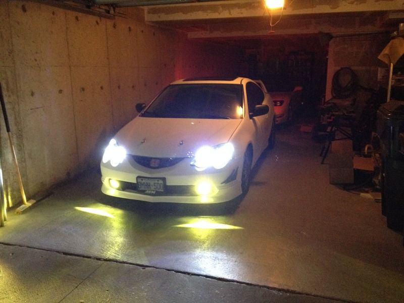

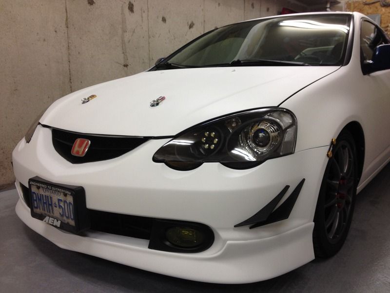

Paint was getting rough, decided to plasti-dip the car matte white. Should be fun to keep clean. :rest
Also did my own retrofit with Morimoto H1 projectors and my own custom LED pods for day time running lights. I 3D printed the LED pods and put them in my high beam spot. They do a cool power on sequence when I turn them on (I made my own PCB to do this).
Also bought the "Acura Oval" LED fog lights from the Retrofit Source. They are meant for a TSX (I think) but I fit them into the OEM openings. Requires some minor trimming and messing around with the mounts on the back.
Also added some rice hood pins (my latch recently broke) and front canards from ebay that say "drift" because this is clearly a bad ass drift car. VTEC + intake means I need more downforce :vtec: :laughing:

I sprayed the car with an Earlex 3500. It was a dipit.ca kit
Used 2.5 gallons of regular white plastidip (pre thinned) with no base coat and I did not put any sealer on it. I'm sure it will be a big mess in a few months but time will tell. Not sure how many coats, but it was a lot. At least 10 because the HVLP coats go on very thin compared to a spray can from my experience. I've driven it for the past week on the highway etc, and the front does not seem to be chipping off.
