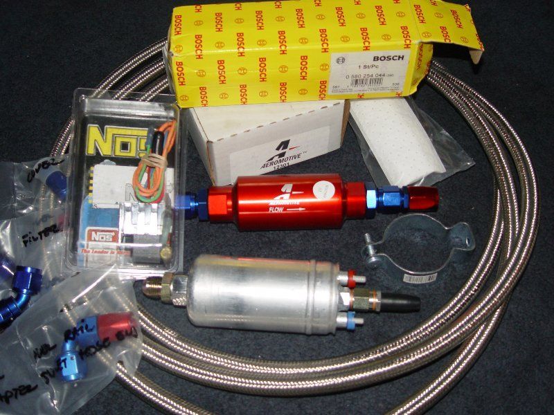

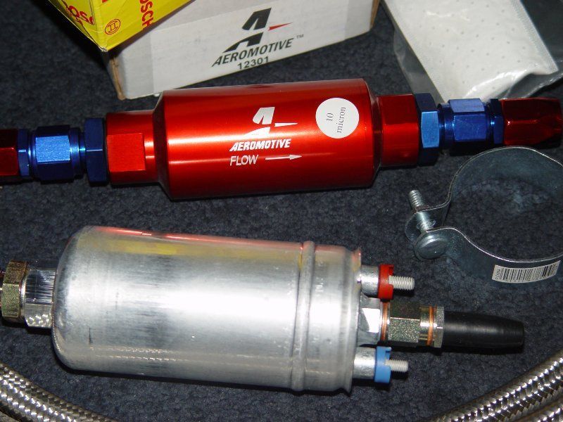

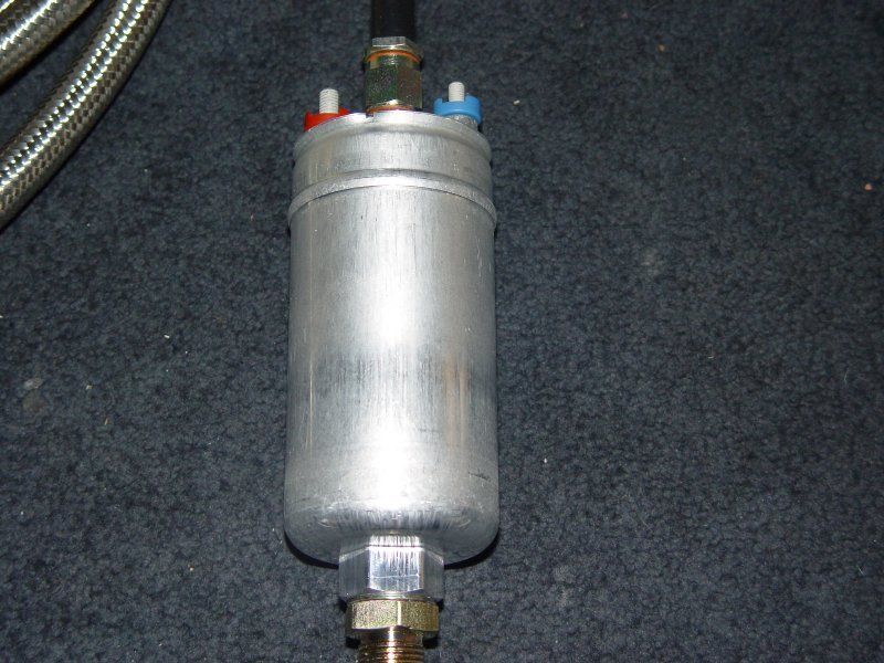

So I got tired of the walbro pump not being able to produce the fuel volume I need, I also got tired of the low fuel lean cut. I talked to stan at fast turbo and he had this system for the rsx. It should work really well and give me the fuel volume I need and fix the low fuel lean cut, it really sucks having to run a full tank of fuel in order to not get lean cut. I will be installing it today or tomorrow and I will have some pictures of the install. There is also fuel pick up I did not get a picture of that

I got the same kit from Stan, but I'm still waiting for the FPR & Fuel rail, plus I didn't get the thing in the NOS package, what's that? A relay?
Also did you get any kind of instructions from him?

4,780 Posts
Discussion Starter · #16 · (Edited)
Djstorm100 said:
thought so... is that a intake fuel pump or does he keep the walboro in the tank and put that somewhere under the car?
The bosch pump goes under the car and the walbro will come out
Yeah the thing in the nos package is a relay I did not get that from him I got it from tony at adf.
No he did not really give me any instructions but he explained it, I will do a write up in a few days.
I dont think I got the fitting for the outlet of the pump I will have to call him tomorrow

Pretty expesnive the pump alone is like $280

I am using These clamps they come in a set of 10, which should be enough, but I ordered 2 sets just in case. Also I'm using a -8 line, you may need a different size depending on your line size.
The way you run the fuel setup depends on how you plumb your FPR.
If you run it dead head style which holds pressure between the FPR and rail you run the setup: Pickup tube out of tank->braided line->fuel pump->braided line->fuel filter->braided line to engine compartment->into the regulator side port->out the other end of the regulator->braided line->into the fuel rail; return line goes out the regulator bottom port->into OEM feed line->back to the tank
If you run it Bypass style (which I am): Pickup tube out of tank->braided line->fuel pump->braided line->fuel filter->braided line to engine compartment->into one end of the rail->out the other end of the rail->braided line->into the regulator side port->out the regulator bottom port->into OEM feed line->back to the tank
