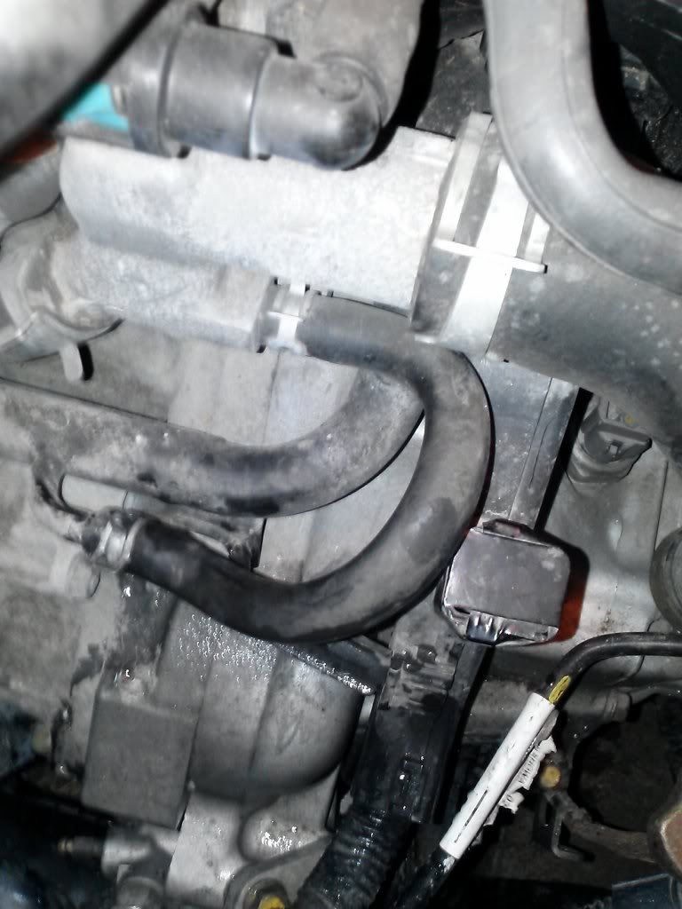

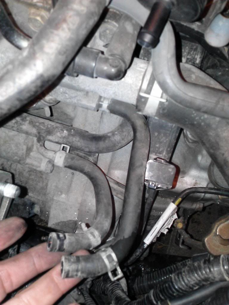

Here's a picture of it. There is a thread on RSX, but I didn't find one here. Very easy and free. Just remove the throttle body, and remove the lower hose going to the coolant pipe.
Attach the upper hose to the lower coolant pipe.
Careful putting the TB back on, it will try to hit the new looped pipe.
