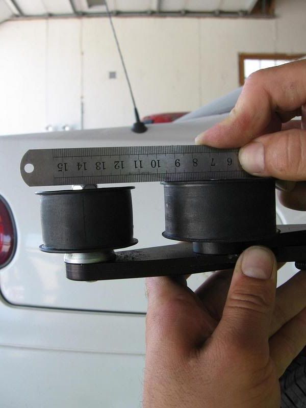

here are some pics of the pulleys and how they are off I thought this could be a reason,

im not running a manual tensioner but that does not look right at all

the belt is suppose to be broken in after a good 300-400 miles before you can really get on it. That might be the problem and yea, the idlers pulley doesnt look right at all..
:coffee: I would re-check the Alt, PS Pump installation, and would add a oil washer in between the fixed idler spacer, and the one half of that tensioner, thus to bring that pulley in-line w/the other idler. That is not the reason you are chucking belts left and right. Maybe you are tighting the hell out of the belt. Try breaking in the belt for a hundred miles or so then slowly going tighter, but allowing some slip, then just tighten untill the slip goes away then you are done. Its not that hard really. Dont rev the car over 6K untill the belt is broken in. NJoy!

A thought: Could the scissor be bent?
It could be. Easy enought to tell on his end. 99.9% of the time its because the belt was to bloody tight in the first place.

Sure. I would dismount the idlers, then lay the scissor on a piece of flat glass and see if it rocks.
Only reason it looks that way is because of the one idler not being bolted in place, and he has it tilted back a bit as he is takig that photo. Its'in the enlinement.

i think the tensioner is bent

I'm trying to remember if there's a washer between the shoulder of that tapered spacer and the pulley, but can't. That what's missing.
