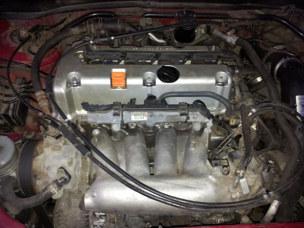

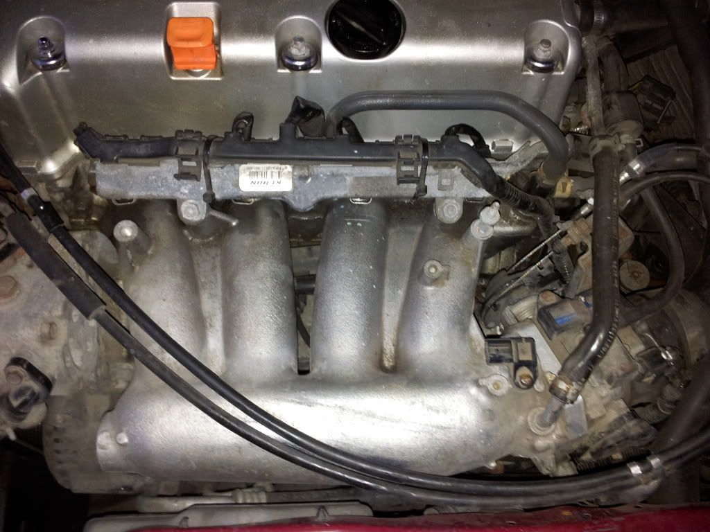

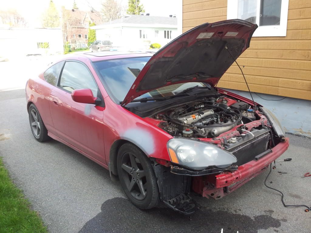

btw im new here but i've been lurking around for the past 3 months and jumped in, i've got recently an Rsx-S K24/k20:vtec: and i love it but since my friends are also moded cars i need more punch in it:chillout:, im ready to invest and to put the time, sure thing less expensive the bether it is cause i can do more :p ill give you pics of the car cause i dont completly know all that there is in the car and from that mod my car for bether power, (and yes the car is in a bad esthetic shape i'm fixing it slowly)
so i hope i'll be able to make the best with you guys
i'm aiming for a high 12 sec street legal car, so i'll have quite a bit of mod to put considering i got a 14,575 at napierville dragway yesterday
Edit: i don't think i got cams but i know its a k24, with k20a2 head and the TB isnt from the car, the computer is it stock? maybe you guys know...:eek:
Edit #2: the TB is a RBC i got DC sports Headers still an unknow CPU
-Jon

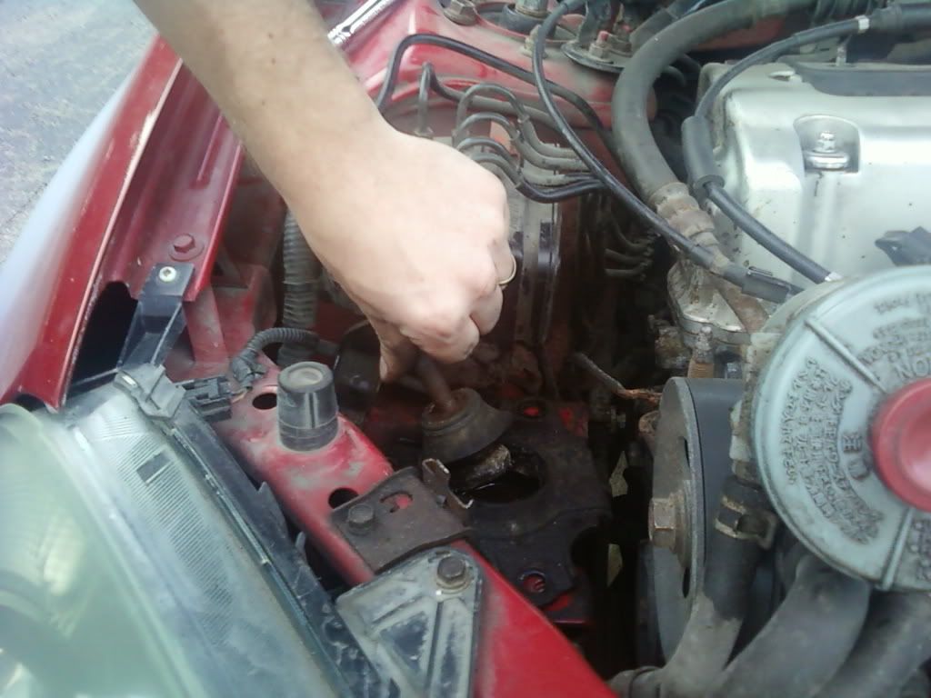

for the engine mounts should i get inserts (i dont think its going to do the job) or innovative or Hasport mounts (also it its worth really going for a race/track) ?

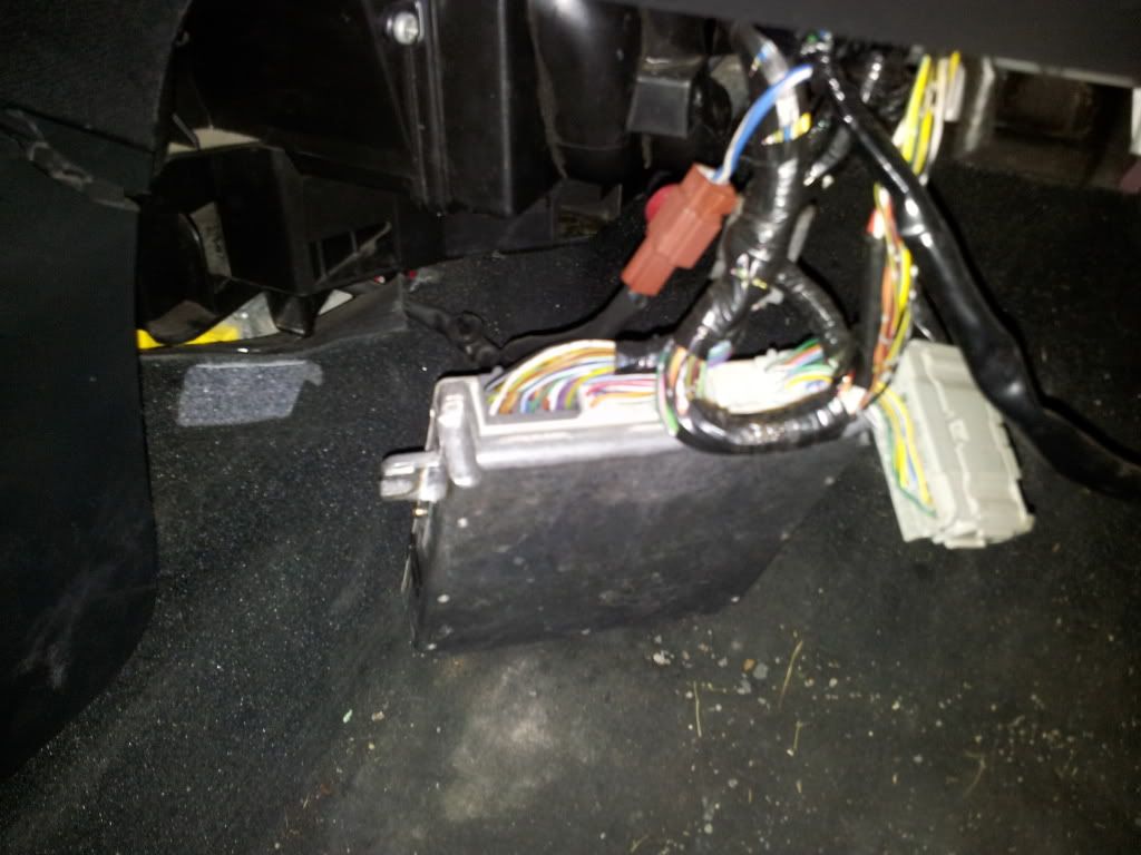

(other post moderated since pics) i've got a k24a2 and also took pics of my ECU you'll see them soon (think its a k-pro)
looking for a LSD system since it should help me with my 1/4 mile time with a stage 4 clutch (got a recomendation?)
as for cams the drag cartels seems awesome but i dont know what valve/springs to match them
i can show you guys more nsx pics if you want also ;)
*EDIT* belt seems to be on its last milles, on a k24 with AC compressor, witch size should i get?

I've had good success with Innovative 75a mounts. the 65a usually gives out with anything more than a stock engine setup.
LSD - Quaife is the preferred differential (but also the most expensive)
Springs and retainers. I'd say the best budget setup is Supertech 1021 or 1022 with corresponding supertech titanium retainers / seats / seals. If you're looking into big $ for american springs, there are other options (psi, pac)
a tsx belt should work for your engine.

1. get some mean green and clean up the bay. spend a day cleaning and looking for other missing bolts and get everything in order. DO NOT start putting mods on that car until you know exactly what your working with and that everything is secure and in good working order.
2. I may be wrong on this but im pretty confident in saying that the car couldnt run on any stock ecu. Find out what it is and how to work it. Get your software and learn a bit about it.

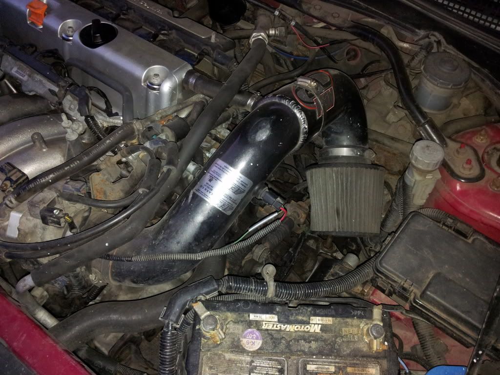

3. Get rid of the aem V2, get a true Cai. Not sure what your looking like on exaust and im not familiar with the exaust setups for the frank k24a2s but any motor basically works better for higher hp under the principal that more air in + more air out = higher hp. lots of cam choices, do some research on cam and valvetrain setups and those things should get you fairly close.

the exaust is a 3'' straight pipe with a DC sports headers, seems good IMO, im wondering if a CAI is really worth the shot?
Changing to a different header and the CAI will give you very good gains. I didn't read the whole thread but you seem like cams are in the future and if that is true the dc sports header will hold u back along with that intake.
And yes that is kpro if no one has answered that.

Really like the NSX...
Do you know who tuned the car or if it's running on the stock kal off K-manager? Tune would be a solid investment once you the little issues resolved. Also you can use that v2 do some minor mods and you have an intake that sits below the battery...
