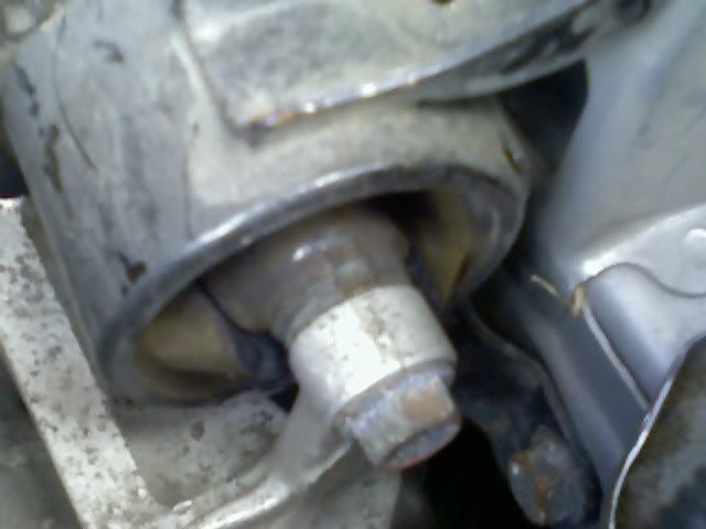

i noticed the torn mount after installing my CAI about a month ago and since then its been ok until yesterday and today.then today i found a piece of the mount hangin off it ...so i pulled it off..every time i shift my whole car jerkys horrible and im easing on the cluth and being nice with it....i am in desperate need of a new tranny mount....do they make aftermarket tranny mounts ? were and cost? +rep 4 help

Innovative Street Mounts, their in the CRSX store

do you know about how much a shop would charge to install them
good price $100, expensive $250
find something that you can trust in that range...maybe you could find an RSX'r close to you that could help install for some cash

i know theres about 5 clubrsx peeps in richmond lol...but i dont know any of them...285$ for the street kit is ok....do you know how much for just a stock tranny mount ?

probley jus go with the stock one for 60$....how hard is the install if i do it myself :dontknow:
4 bolts, 3 on the mount and one that goes through the mount...replace, tighten and done

Hard shifts/wheel hop will do it.
But with the inserts or full mounts enough stress is taken off that the stock tranny mount is fine.

Damn, I just threw my original tranny mount away after waiting 6 months for someone to snatch it up! No interest = into the dumpster.
I recommend Innovatives, if you can afford it. If you're going to keep the car for a long time, I def recommend Innovatives.
Interesting - it's usually the front and sometimes the rear OEM mounts that tear. Anyone else here heard of a trans mount breaking? If so, were the front and rear still intact?
