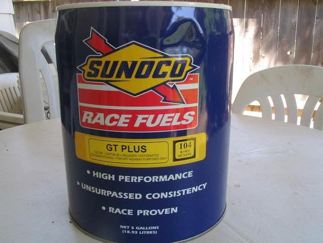

Last but not least if we have time and I have enough money left over im going to bolt on that downpipe str8 onto the cat and dump a little of this in the tank...
