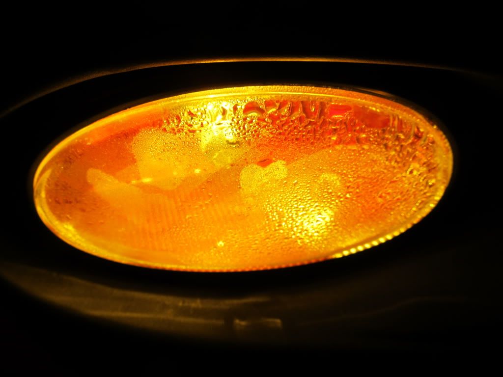

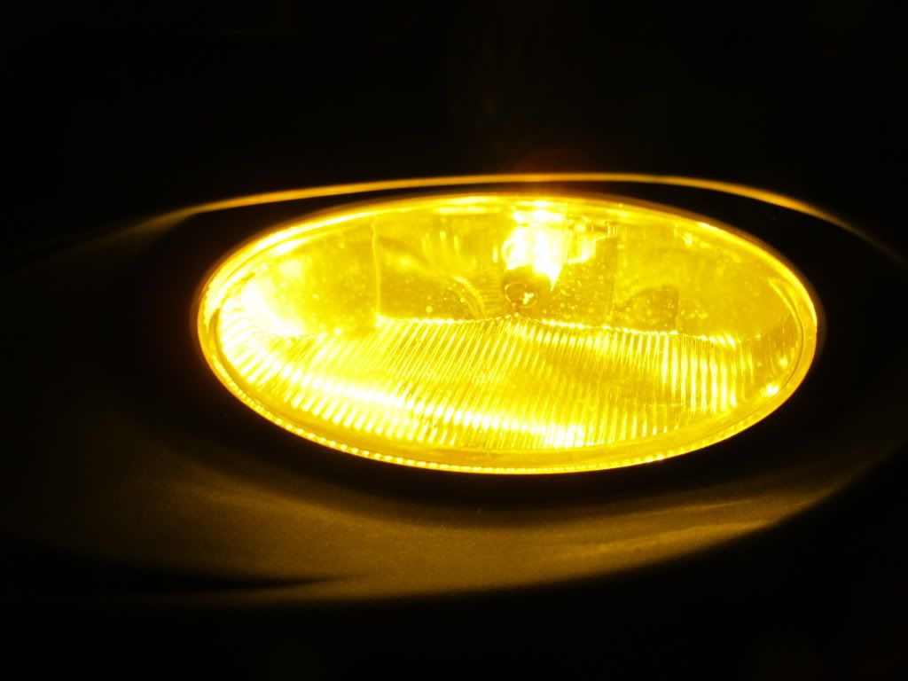

I ordered the yellow fog lights from XenonDepot and within 3 weeks I had really bad water and condensation in my passenger fog which made the housing inside start to turn red. The drivers side fog didn't have water but had little pieces of dirt in the housing. Obviously there is a seal that broke but once I removed them from my car the bulbs seemed pretty tight.
Has anyone else had this issue with the yellow fog lights from XenonDepot?
Here are some pics to show you what I'm talking about.
Passenger Fog:
Drivers Fog:

They e-mailed me a UPS return label, I'm only returning the fog lights though, not the harness and switch and what not, what about you? I've got mine packaged up already, mailing them back tomorrow as well. I found out where they were leaking from.

I know what you mean, I zip tied my fog harness to the bumper so it won't fall and start dragging and what not. Anyways, mine were leaking from the poor caulking job that the yellow lens connects to the housing. I'm going to do some modifications on the new set so it won't happen again.
