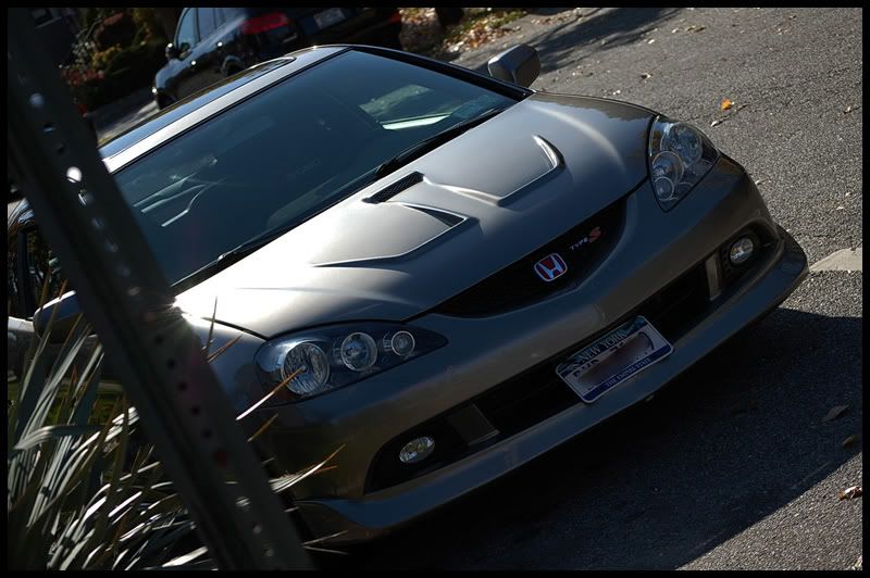

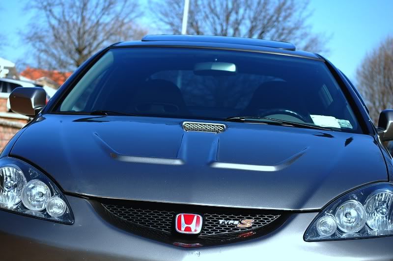

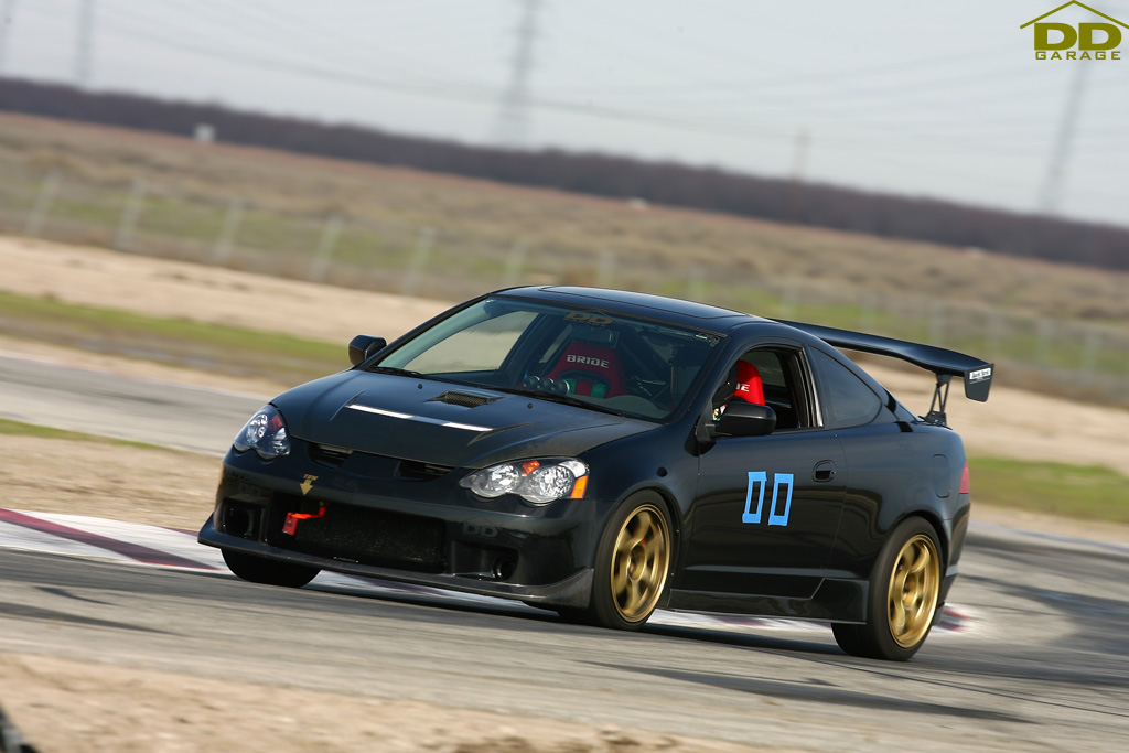

Just wondering if anyone had ever built a custom/vented hood for the rsx, got an extra mint hood that was painted the same color as my car and was just gonna play with it to see if i could make it like a track hood, i know they sell vented hoods but ive got an extra spare oem so just wondering if anyones ever done it, posting pics would be nice, anything can be custom fabed up so im not really worried about the designs being too complicated, im really trying to get technical with this hood build because i know you can actually reduce engine temps and ive heard you can create more front end downforce somehow, just trying to maintain oem look and still actually do something good
Here are some of the hoods id like to try to design something like, dont be an ass, if you got something negitive to say just please GTFO :gtfo:

Would fiberglass be suited for the temperatures of the engine? Actually nevermind forgot our hoods are made of fiberglass LOL. I would replicate the max raxing hood by using metal sheets if thats possible but not sure because in the picture the hood looks raised.

now these are horrible drawings but you get the point lol :laughing: the max racing hood seems like it would give your car more downforce because of the vents being placed upfront, but heat wise you'd still be getting mad heatsoat, the other one would produce less heatsoak for my SRI, now during the summer i push the CAI and my intake doesn't get heatsoak anyway, either one is simple to make, not a big deal cut wise, i wanna go with the max racing design because i dont really autocross or drag during the winter when i have my SRI on, but during the summer when ive got the CAI i do, but with the other design #5 i see it being a better "best of both worlds" type of option, guess im still in the air :dontknow: ive got till friday night when i start

Your design looks similar to the buddy club hood but I'm guessing thinner and wider since your focusing on cooling the header and guessing your short ram intake, the filter is positioned on top.
http://img.photobucket.com/albums/v635/ghetto_89/IMG_1510.jpg
