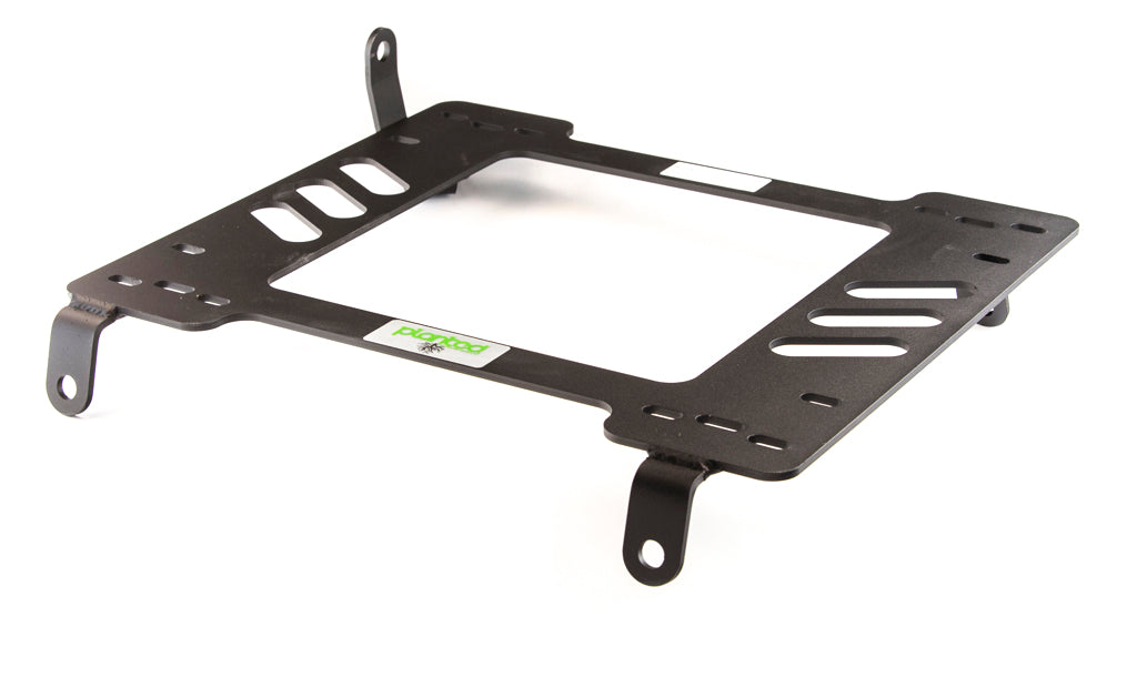

I’m thinking will these brackets be good enough to fit on the seats?
