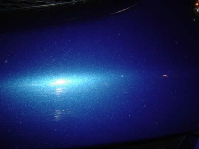

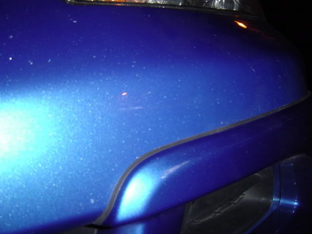

My front bumper and A-spec lip are scratched but the paint isnt scratched off. It left some paint transfer from his car onto mine though. It's the kind of scratch that you would see on a used CD or DVD. Looks like surface scratches that don't affect the paint. I tried rubbing it off but it isn't working. Does anybody know how much it will cost to get rid of that or fix it? I am absolutely stressed and very pissed at the incident that happened even though it was an accident that nobody wanted to happen.

- Left minor scratches that are colorless on my front bumper (appears hazed looking)
Main Question
I heard this can be fixed by either buffing or doing touch-up paint (rather not because of pricing). Half the bumper and corner of the aspec lip is scuffed. Does anybody know or can give me an estimate how much it should cost?

this will be a noob question but, should i do it with a porter cable? i never polished before nor do i have a porter cable. but if it gets the job done, i think ill go to a detailing pro and have them do that spot if itll really get that out. do you think it'll make the marks go away entirely?
#7 ·
You're gonna need a real aggressive polish to get those out, then finish with a fine polish, And yes use a random orbital porter cable.

I don't even see anything.......I've got same amount of scratches just from driving on freeways......but yeah, you're friend's an idiot - should have kept his foot on the brake, better yet, not put it in reverse at all. Work it out with him.

dude that can easily be buffed out. i would do it for you but i live in PA. Go to the car care forum and see if anyone from FL has a pc that is willing to help you out

Use lacyr thinner on a cloth and wipe over the area, then use a cleaner wax on it with a buffer, after that use buffing compound on the buffer, then wax by hand and then use swirl remover by hand. it will work, i work at a detailing shop.
