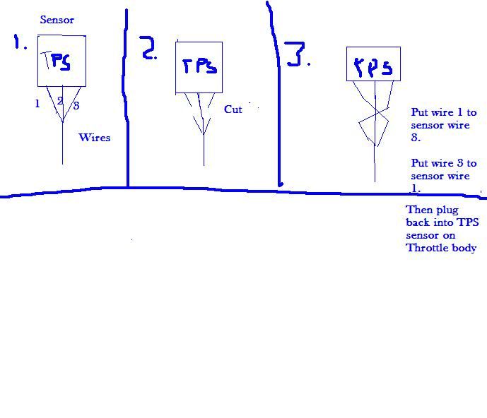

-Type S throttle body fits better but I used the base one just had to modify the rad support a little. If using Type S Throttle body you will have to rewire the TPS. There is three wires 123, you have to switch 1 and 3 to make the sequence 321.

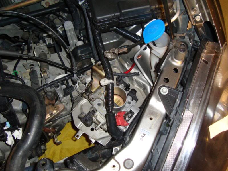

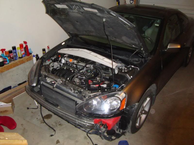

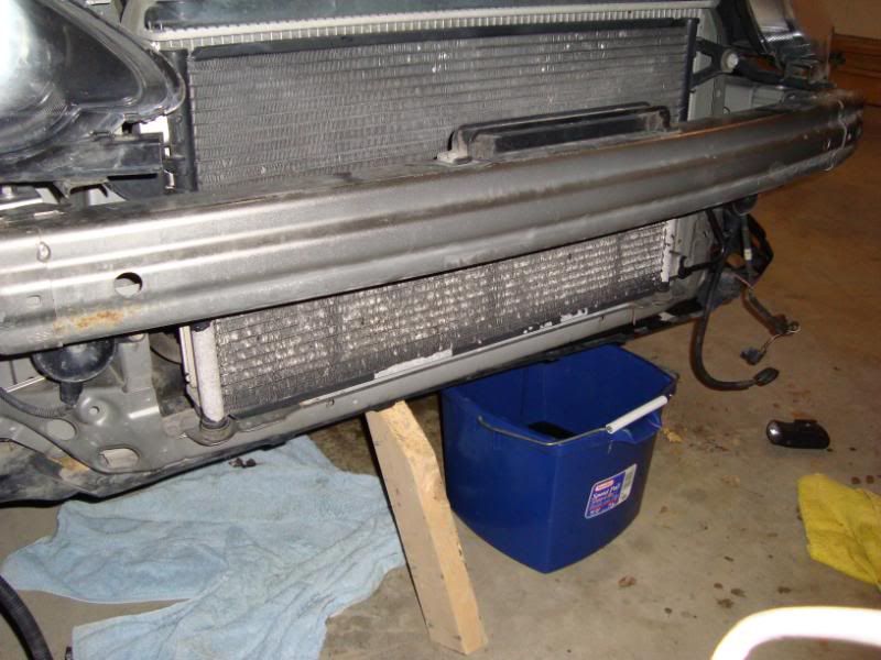

1.First start by removing battery and anything that be in your way. Also it helps to drain the coolant (makes things so much eaiser) If you do not want to do this then make sure to plug off the any coolant lines removed or you will be in for a mess.
2.Remove bumper, spash sheild, and loosen the bolts on the rad support so you are able to move it around to make things eaiser.

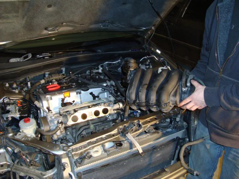

3. Remove Intake.

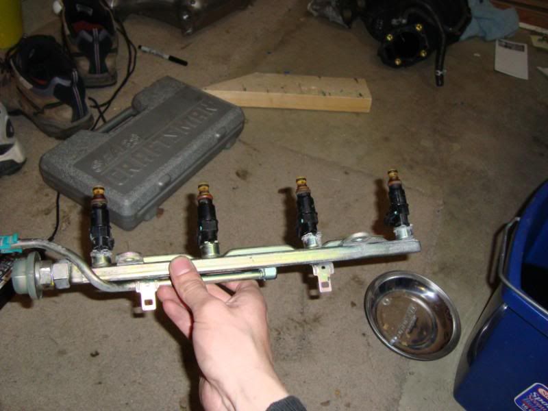

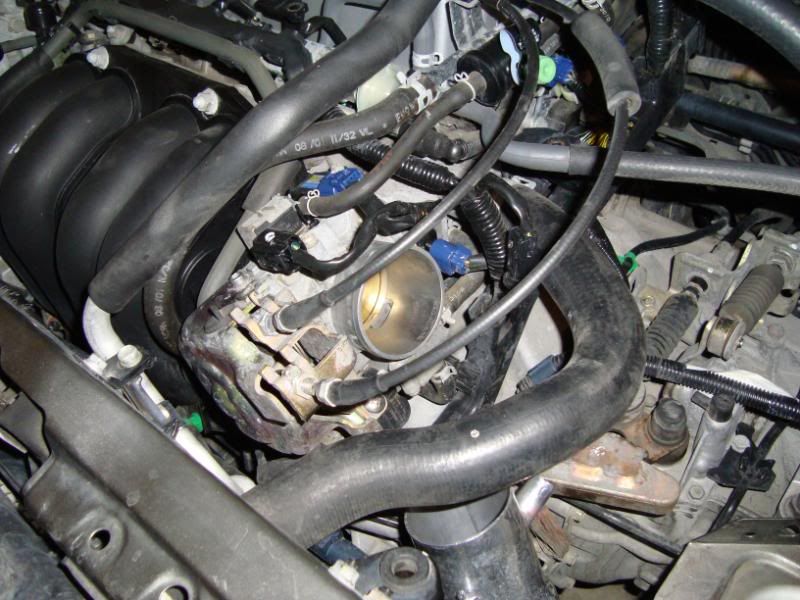

4.Release the pressure on the fuel system, Remove the EVAP hose, Brake Booster Hose, PCV hose, Vacuum hose, Water bypass hoses, throttle cables, fuel lines, fuel injector connectors,IACV connector, TPS connector, Map sensor connector and EVAP conister purge vavle connector from your current intake manifold and throttle body setup. Make sure all sensors and hoses are removed and proceed with the next steps.
Remove Fuel Rail and Injectors
5. Remove Throttle Body ( I just placed it in the battery tray)

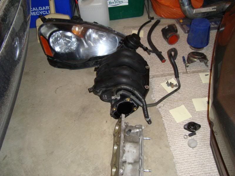

6. Remove Intake manifold and Intake Manifold Gasket (base intake manifold comes off in two peices)

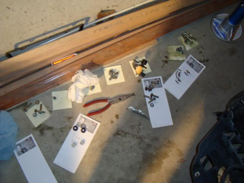

Make Sure to keep Track of Everything!!!

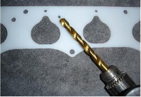

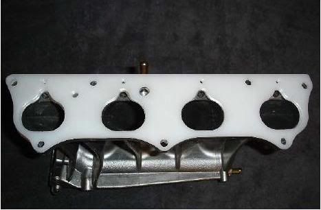

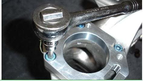

7. locate port atop the flange on your RBC manifold that stems from the nipple and mark and drill a 15/32" into your intake manifold gasket to line up with this hole. (Thanks to Karcepts for these Pictures)
8. Bolt up Karcepts adaptor to RBC manfold with supplied bolts

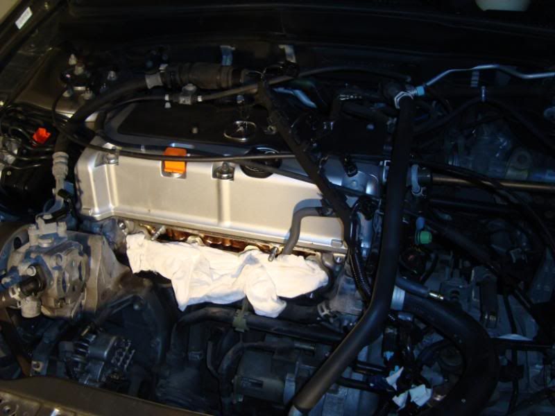

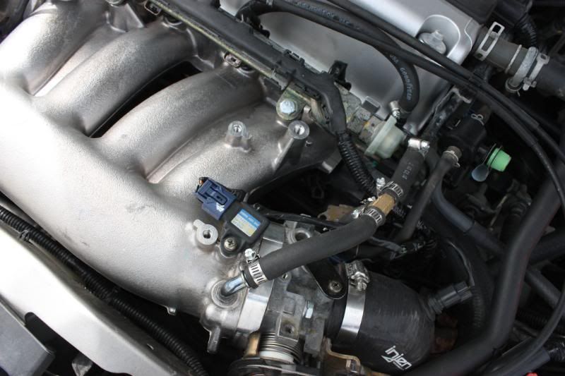

9. Install throttle body onto RBC you either have to relocate the MAP sensor to the top of the manifold or drill a small hole in the throttle body gasket where the map sensor reads so it can read properly. (I relocated it to the manifold)

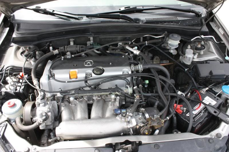

10. Reinstall RBC Manifold, plug in all sensors, hoses, fuel rail, injectors etc
Also remember to install the provided vacumm hose onto the nipple atop the manifold flange and to the intake air bypass control valve
11. Check for clearance issues. I had to bend the A/C line a little bit to the right side to allow the hood to properly close no big deal.
12. Open up K manager in K-pro uncheck the secondary dual runners option under parameters/ Vtec.
13. GO GET A TUNE! *** Very Important***

SHIITTTY CHART of how to rewire TPS sensor(for Type S Throttle body only!!!!) Because I never took pics of that.
