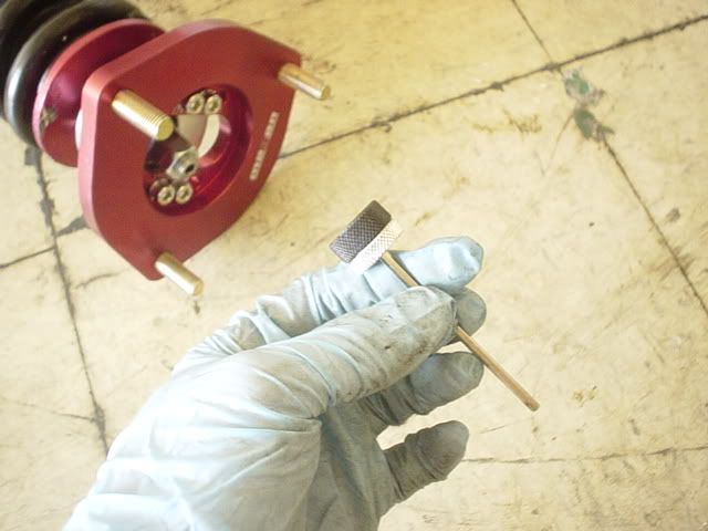

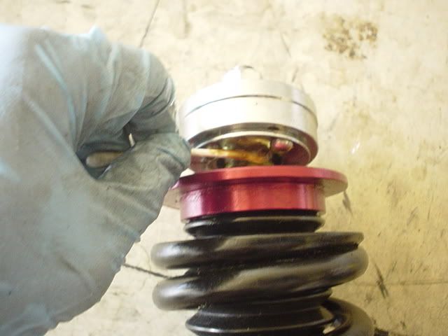

To adjust height while the coilovers are installed on the car you need to twist the shock body which is very hard to do. To make things easier you can use the spanner tool and hook it to the highest lock nut (the one that sits right below the spring) and turn it clock wise if you want to lower the height. If you want to raise it higher you need to hook the spanner tool on the middle lock nut, the one right below top lock nut and twist it counter clock wise. The whole shock body should twist and rotate too. If only the lock nuts are spinning, make sure you tighten those 2 upper lock nuts together real hard.

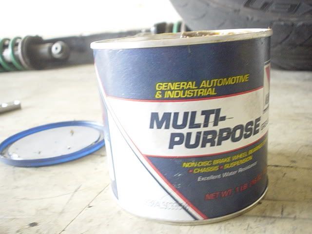

About the sound problem you're having, It all sounds very familiar. You just need to lube the pillow ball correctly. What type of grease did you use? A lot of people do them the lazy man way and just spray white lithium grease at the pillow ball while it's still installed on the car.
Hope this clear things up for you. I know it's really hard to follow directions where there are no pictures lol but good luck man.
before i installed the coilovers i lubed them with high temp synthetic grease. maybe i just didnt do a good enough job. also do you think that i might have the front adjusted too low since i have the front at the lowest setting?
