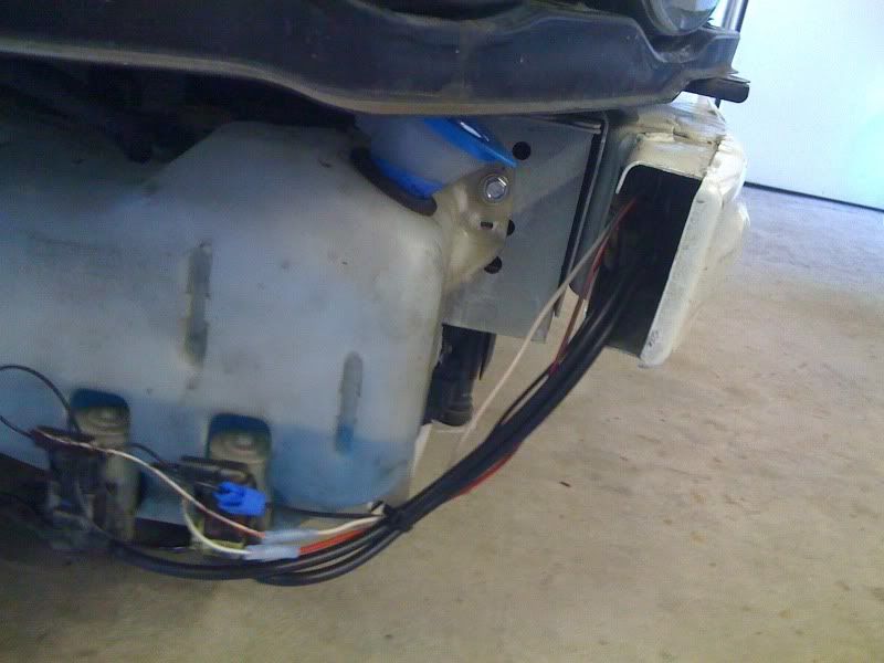

i ran the wires and tubes through the front bumper support.
as you should be able to see in the pictures shown below.

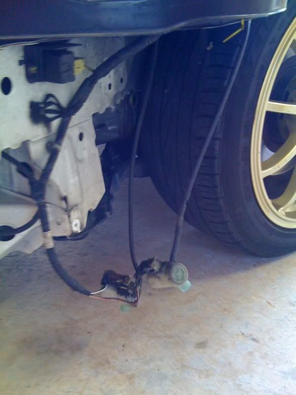

i started by relocating the washer bottle.....

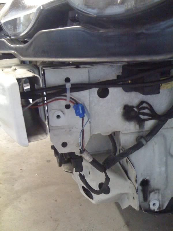

a pic of the wires, and the location where the fuse box will be going...

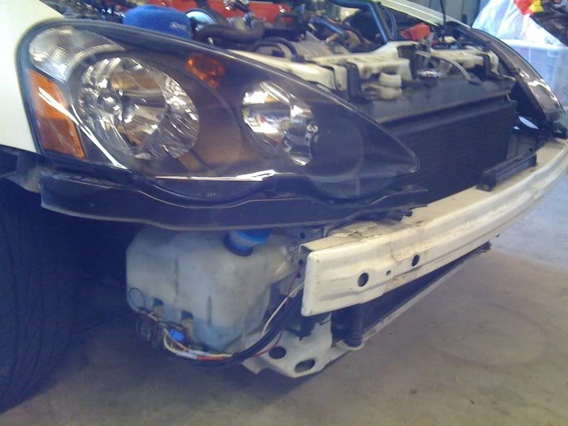

and the end product..
