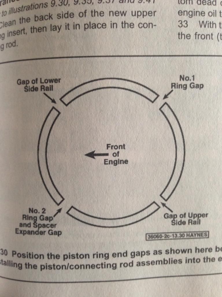

I made a video of how to properly install your piston rings and having them properly clocked to get the job done. One of my dads friends works for summit and he gave me a diagram of how they clock their rings so that is what I followed.
Here is a Removal Video for your old Piston Rings.
https://www.youtube.com/watch?v=mJNFUYg47Bg
Here is a Installation Video for your new Piston Rings.
https://www.youtube.com/watch?v=k-JWU46HwdA
If you don't want to watch the video here is a picture.

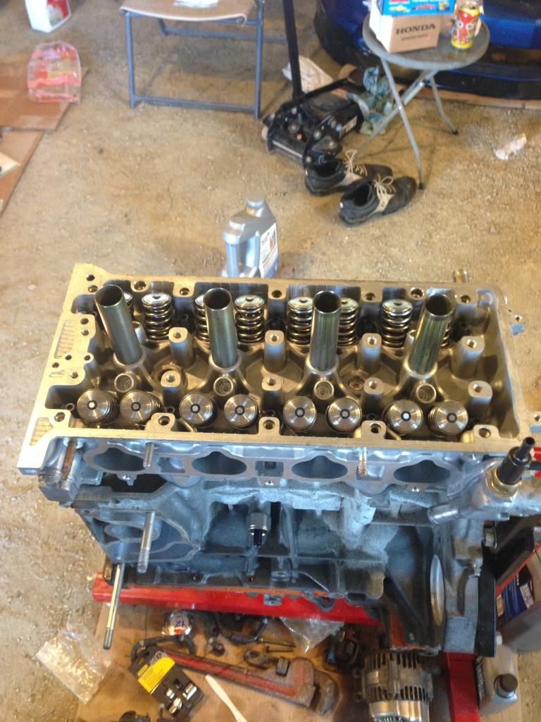

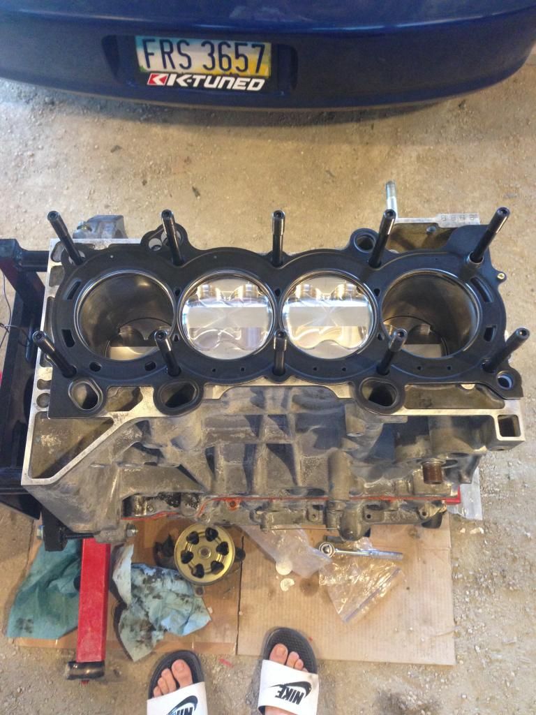

9th: I then went to install my Head gasket. My head gasket needed to be thicker than the previous stock headgasket on my K20.
Make sure that you have both Dowlpins installed on the intake side of the top of the block to properly lign up the cylinders. I lost one and later found it and had to tear the entire cams/head back off. Also will want to make sure that the small Washers built into the gasket aren't contacting where the block is going to be making contact with the head.
10th: I then started installing my arp head studs. Fingertightening them first and using the assembly lube that came with the setup. Then on the bottom of the washer I also installed the assembly lube and tightened the head down in this order to prevent warping in 3 equal steps after the 3 steps my head studs were tightened to 80ft-lbs.
Step 9+ARP Head Studs^
Then Head installed

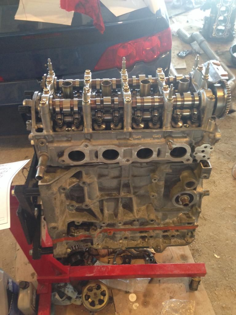

11th: I worked on Putting my Prayoonto Stage 4 Custom cams in. I hot tanked mine myself. Boiled a Pan of water put it in my bathtub let it set in there til it was clean. I DID THIS WITH MY OEM CAMS installed with the rocker assembly still. Then let it air dry outside in the hot sun. THERE ARE SPRINGS THAT ARE IN THE ROCKER ARMS. DO NOT LOOSE THESE. YOU DON'T HAVE 1 OF THEM AND GUESS WHAT YOUR VTEC ISN'T GOING TO ENGAGE AT ALL. Anyways, here is a Video of what I did. I used a impact to get the cam gears off the cams. 17mm socket, and a 14mm Socket. The allen wrench end I believe was a 8mm allen wrench. After you pull off the old cams. You will want to wipe down the part where the cam lays. Use a microfiber cloth you do not want to scratch this. After it is all clean hook up the allen wrench head bolt and the 17/14mm bolts that are holding on the cam gears. Then you need to grease them after getting both the top and bottom greased turn the cams a little back and fourth to get them lubed up Store them then in a place they wont collect dust/dirt.
http://youtu.be/URKuQuKCNoc
YOU NEED TO GREASE the heck out of the lobes of the cam that are touching the parts of the head that are making contact with the cams..

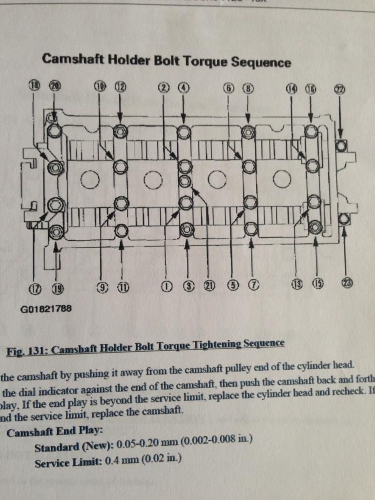

12th: Installing the Rocker arms/cams onto the head. I had help from the girlfriend to help me keep the rocker arms up the first few times I attempted to get these bad boys in. Then after I had to tear down everything I got the experience of doing it myself. This is a task my friends. It is not easy. What I did was I decided to take the rocker arms and use a piece of tape for each set and tape them up around the top of the cam holder bolts were. Went out set it down and it was easy as cake. I suggest if doing this yourself to make sure you tape them up or have a few extra hands their that can hold them up while you are trying to lign up the cam bolt holders.

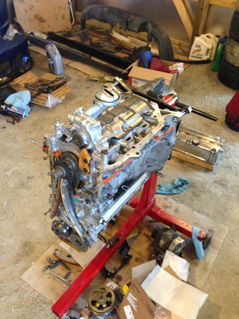

Step 14: Putting on your Modified Oil Pump. Before you bolt the pump down get the chain in the teeth of the oil pump. Then you can bolt it down. this is the only way you will be able to get the chain on the pump properly. If you dont do it this way you could damage the chain or stretch it and you dont want to do that.

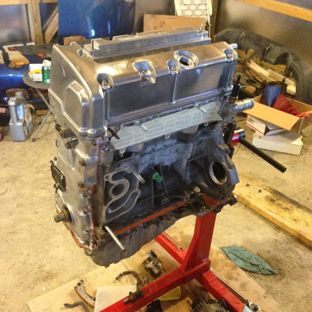

Step 15: Get your oil pan and your K24 chain cover and put some RTV on it just like in the picture below.
You then will want to install your VTC Sensor. Also when you are putting your chain cover on you will want to have put the K20 Crank position sensor put into the chain cover.

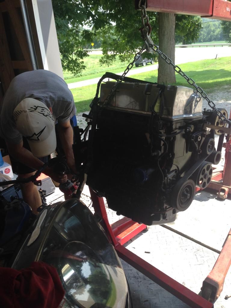

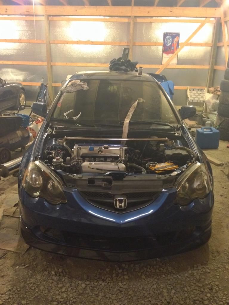

Step 17: Drop the motor in the CAR! WHOOOOOP. Im not gonna waste my time telling you how to button up your TB or Intake Manifold there are many other DIYs for that. But boom you just built your K24!
After all this was done I decided to switch over my Sensors from my old block to my new one.
Switched my Knock Sensor, Oil Sending Unit, Crank Position Sensor, I didn't move my oil cooler over to my new engine seeming how that is a not really needed mod. You also will need a CRV passenger side mount.
And ALSO on the head installation. I forgot to put the LMA springs in the head went and had the car dynoed and now have to clean the motor out and have the head redone again so I will be sending mine out to 4piston to do a moderate port and polish! DO NOT FORGET TO PUT THOSE SPRINGS IN THE HEAD LIKE ME.
